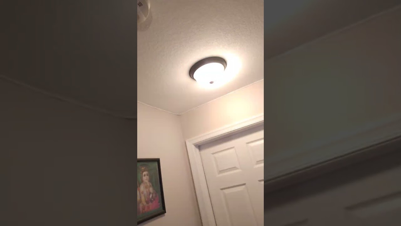

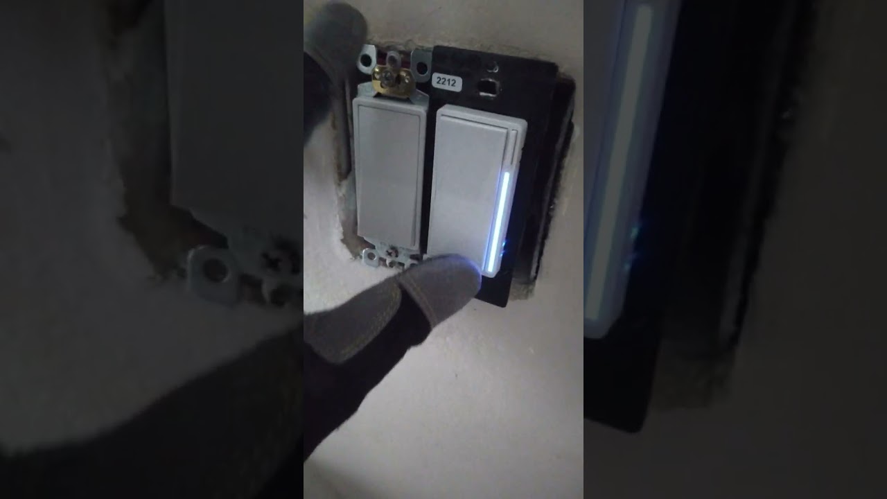

Saturday I spent a couple hours trying again.
I got dimmable LED bulbs from homedepot - https://www.homedepot.com/p/EcoSmart-60-Watt-Equivalent-A19-Dimmable-Frosted-Glass-Filament-LED-Light-Bulb-Soft-White-4-Pack-11FFA1960WESD01/318284624
The same-ish problem again. The smart switch doesn’t do anything to affect the state of the lights. The dumb switches do affect the state of the light, though now instead of blinking on and off the lights flicker in a not as bright state. I took video this time so those are linked below.
This shows what happens with the smart switch and dimmable bulbs. Its hard to see how the light gets dimmer and flickers due to the camera adjusting exposure. I also showed how I used the config button to set the switch to three-way-dumb and on/off mode.
Here’s another video with the setup using all dumb switches working as expected
