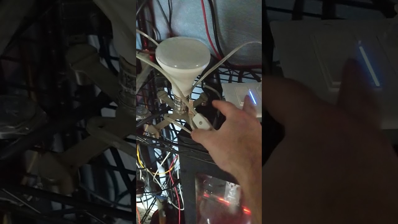

I can recreate the issue with my Red series Dimmer, but it appears to be caused (in part) by particular bulbs.
My setup:
Dimming Speed: 0
Dimming Speed from Switch: 3
Ramp Rate: 0
Ramp Rate from switch: 0
Minimum Level: 1
Maximum Level: 99
Auto Off Timer: 0
Default Level (Local): 0
Default Level (Switch): 0
State after power restored: 0
Switch type: 3-way toggle
This switch is not actually wired to a 3-way, but when configured as one, and while using my Feit Electric CEOM100/930/4 (Costco) bulbs, the light does not stay on. When I turn on the light, it stays on for a few seconds, and then the relay clicks and the light turns off. See video.
I have no automations set up for this switch. If I use a different bulb, such as TCP BR30012, I do not experience any issues.
It also appears that the switch does some sort of current sensing to determine whether the switch has been turned on or off. While configured in 3-way toggle mode, turning the attached lamp on or off will cause the switch to turn itself on.
