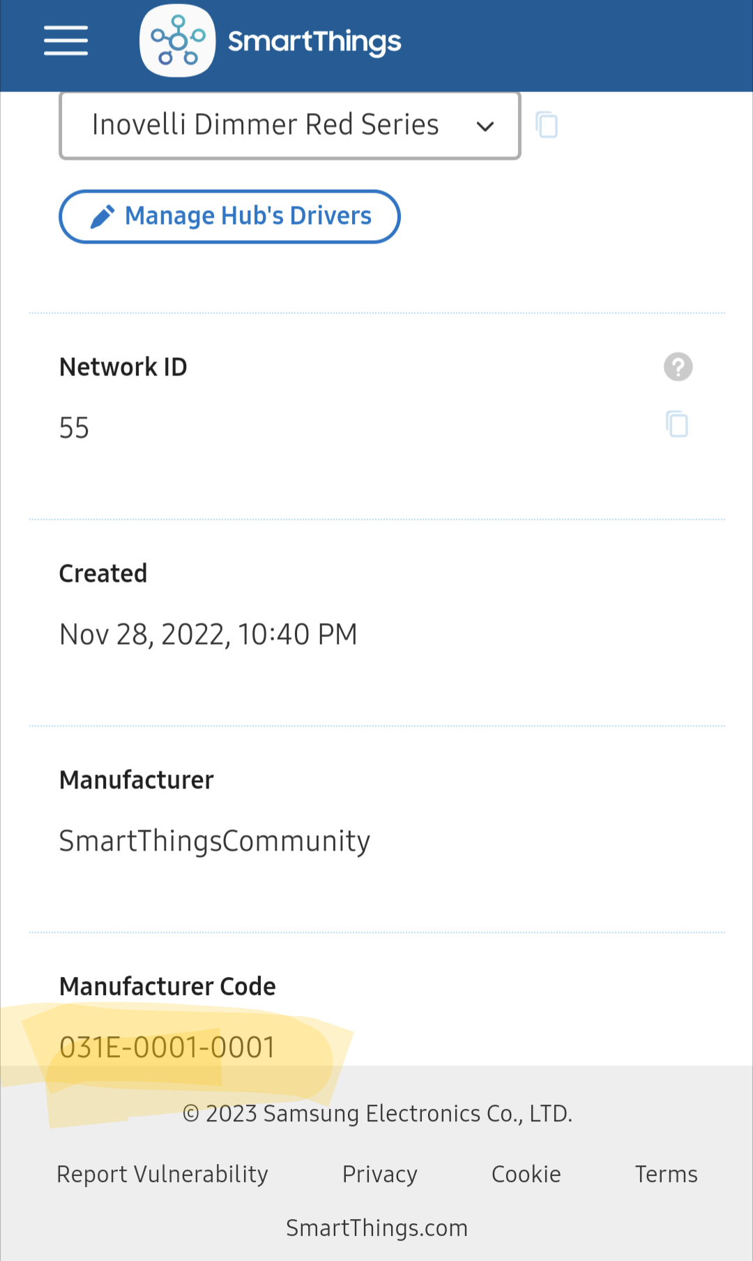

Check in the Advanced user interface and look at the fingerprint (mfr code):
https://my.smartthings.com/advanced/
Does it have a number similar to the one below or all zeros?

Itis all zeros
Yes these are my only inovelli products. Since last night I was able to get 2 of the 3 switches to change drivers to the inovelli red 2in1 but still not bale to get the other one to change drivers in the app it says there are no drivers available but when I go into the advanced interface I get an error when trying to select the 2in1 driver
That’s why it won’t let you choose the driver. The quick fix is to exclude and re-pair the switch. You could try contacting ST customer service but I don’t know if they’ll be able to do anything until you get several levels in to reach a real tech; removing and re-adding devices is pretty early in their list of recommendations anyway.
