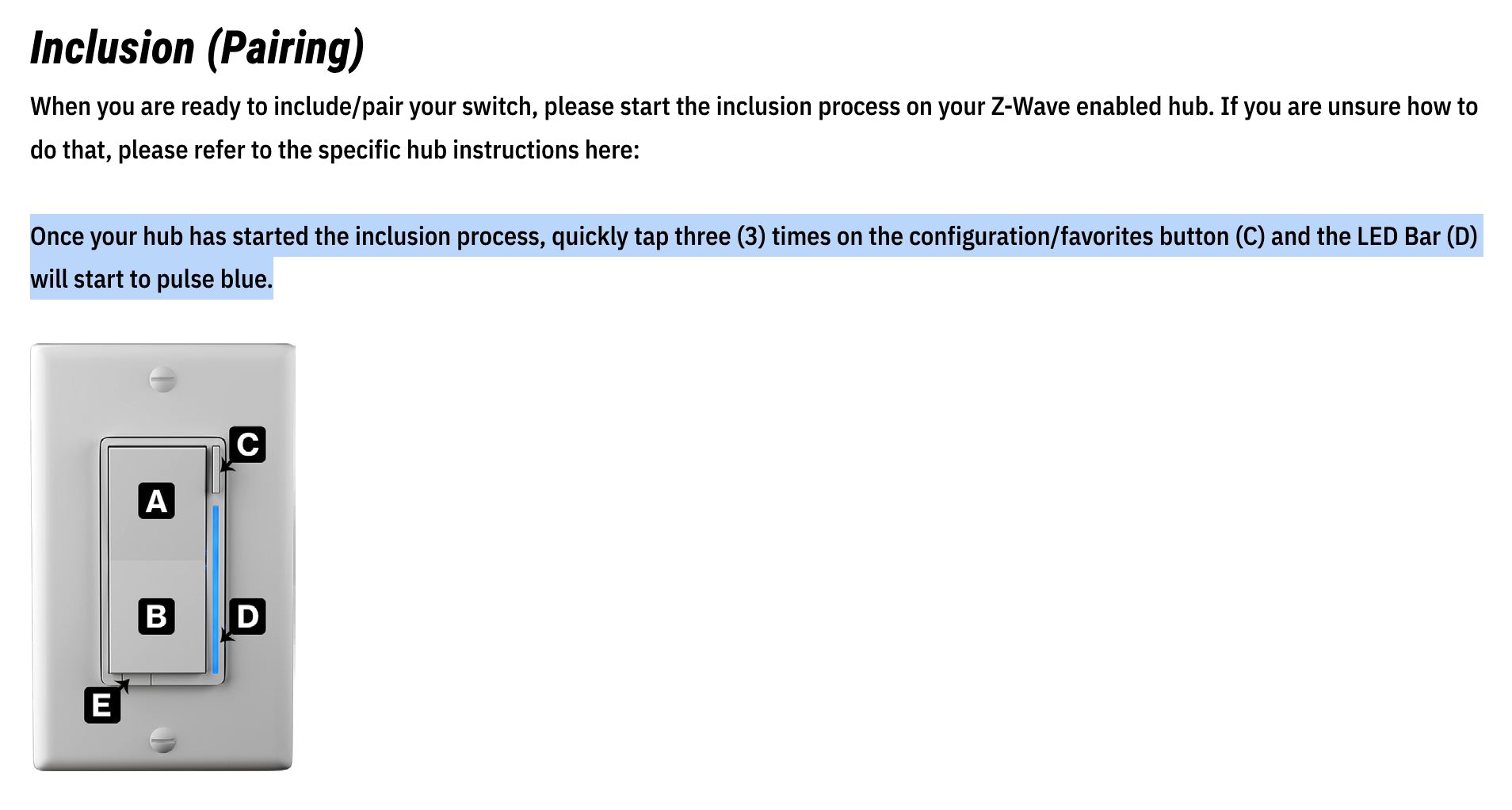

Well putting Hubitat in Zwave inclusion and hitting the configure three times worked. The online manual and one included in the box did not address hitting three times
I think you must have missed it. I’ve done the same thing too! It’s pg. 7 in the paper manual and right here in the online one:
